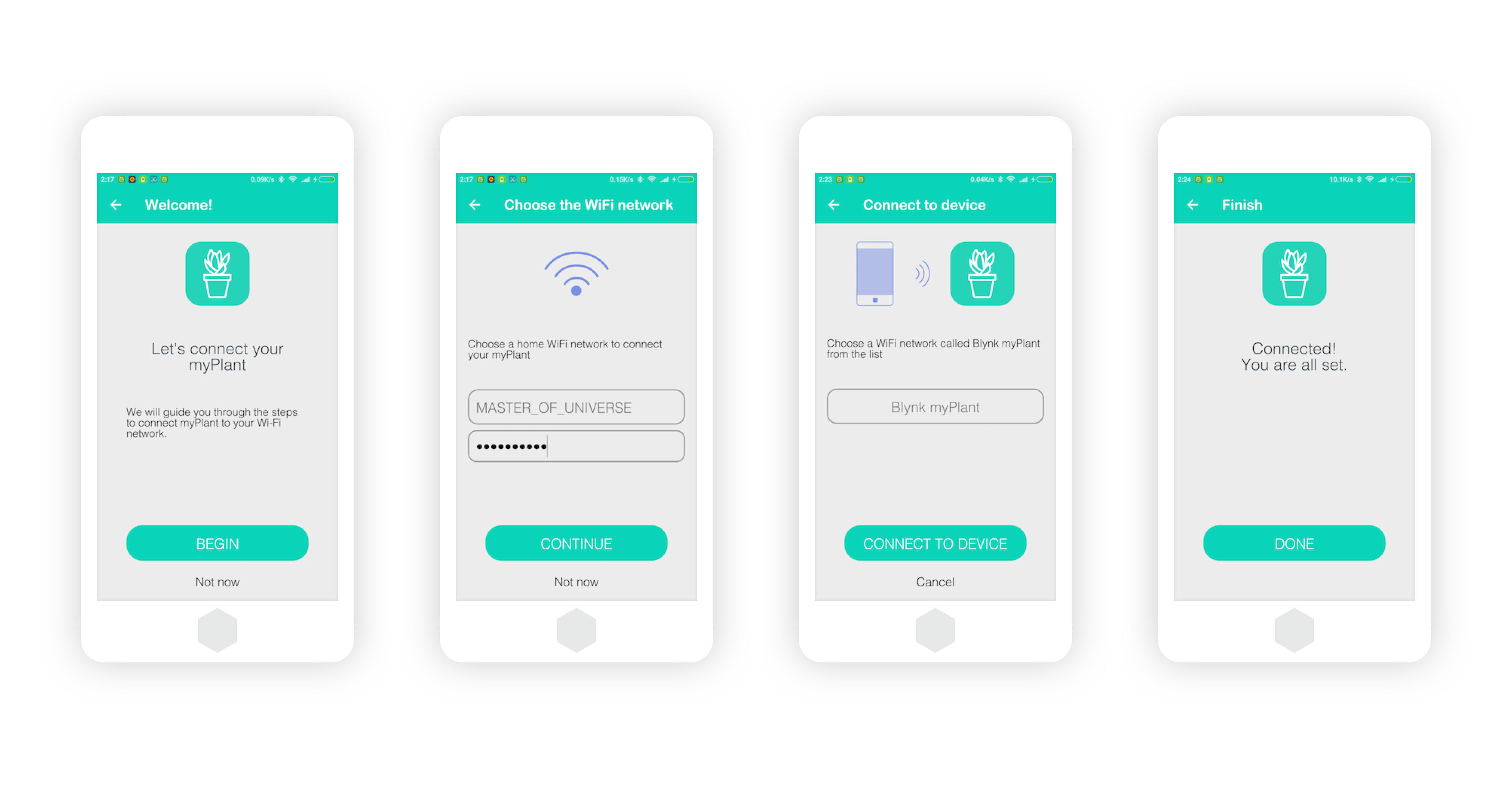

  4. In the app, they will be presented with the Connection Wizard, which will guide them through the steps to connect your product to their home WiFi network and start using it.
Connection Wizard:
  1. Your customers will choose the WiFi network they want to connect the product to (for example, their home WiFi network) and input password.
  2. Then they will connect their smartphones to the WiFi network your product broadcasts. For example: Blynk myPlant.
  3. After that, Device Provisioning Process will start.
During this process:
  1. Smartphone passes WiFi credentials to the device.
  2. Smartphone requests new Auth Token from Blynk Cloud and also passes it to the device.
  3. This data is stored in the device's memory (EEPROM).
  4. Device automatically reboots.
  5. Device uses the stored WiFi credentials to connects to the user's WiFi network. It no longer acts as an Access Point.
  6. Device uses the stored Auth Token to connect to Blynk Cloud.
  7. Your customers can enjoy using your product.
